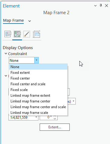

Map Frame Display Constraints
Display constraints for layout map frames can be modified to set limits on the frame's underlying map extent and its navigation behavior. If the layout contains more than one map frame, additional map frame constraints become available. These additional constraints enable one-directional links between two map frames that tie their views together. Each constraint allows you to select the map frame to which to link the current map frame. This selected map frame is called the linked map frame. If you update the extent of the linked map frame, the map frame where the constraint is set updates automatically.
Additional constraints are also available if a layout contains a spatial map series. A detailed description of the display constraints can be found in Map frame constraints in the Pro online help.
Programmatically setting a map frame extent involves configuring and setting a CIMAutoCamera, topic 440 via the map frame's SetAutoCamera method. The existing auto camera for a map frame can be retrieved via mapFrame.GetAutoCamera(). To determine whether a given auto camera's settings are valid and can be used to configure a given map frame, mapFrame.ValidateAutoCamera(autoCamera) should always be called.
A display constraint can not be applied to any empty map frame, a map frame that contains a scene*, and a map frame that is linked to a map series.
*Map frames containing scenes always have a display constraint type of "None".

   //6. Display constraint "LinkedExtent" - there must be at least 2
   //map frames in the layout - the one on which to set the constraint
   //and the one to link to
   var autoCamera = mf.GetAutoCamera();
   autoCamera.Source = AutoCameraSource.MapFrameLink;
   autoCamera.AutoCameraType = AutoCameraType.Extent;
   autoCamera.MapFrameLinkName = "MapFrame2";
   var states = mf.Map.GetLayersAsFlattenedList().First(l => l.Name == "State_Polygons");
   //optional, set intersecting layer to use for the linked extent
   autoCamera.IntersectLayerPath = states.URI;
   //always validate and check we do not have a map series map frame
   if (mf.ValidateAutoCamera(autoCamera) && !mf.IsMapSeriesMapFrame())
      mf.SetAutoCamera(autoCamera);
   //7. Display constraint "LinkedCenter" - there must be at least 2
   autoCamera.AutoCameraType = AutoCameraType.Center;
   //optional, set intersecting layer to use for the linked center
   //8. Display constraint "LinkedCenterAndScale" - there must be at least 2
   autoCamera.AutoCameraType = AutoCameraType.CenterAndScale;
   autoCamera.MapFrameLinkName = "MapFrame2";//controls center and scale
   //9. Display constraint "LinkedScale" - there must be at least 2
   var mf = GetMapFrame(mapFrame);
   autoCamera.AutoCameraType = AutoCameraType.Scale;
   autoCamera.MapFrameLinkName = "MapFrame2";//scale
   //10. Display constraint "LinkedMapSeriesShape" - there must be at least 2
   //map frames in the layout - the one which is set as the linked map series
   //frame and the one on which to set the constraint. There must also be
   //a map series defined on the layout.
   autoCamera.Source = AutoCameraSource.MapSeriesLink;
   autoCamera.AutoCameraType = AutoCameraType.Extent;//set to the extent
                                                     //of the index feature
   //optional - can also set autoCamera.IntersectLayerPath

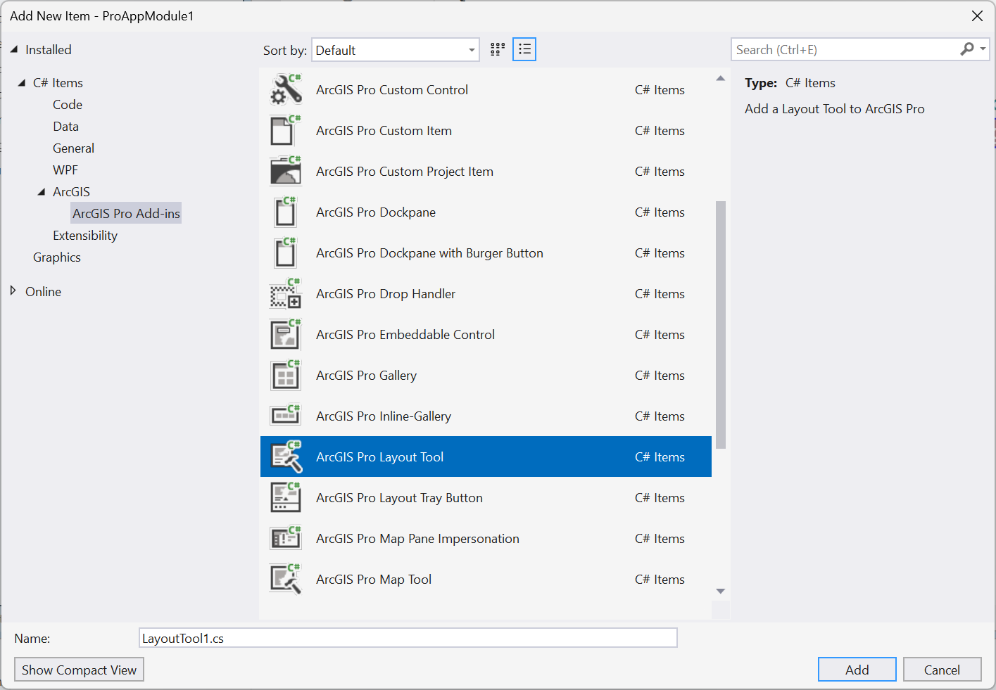

The Pro SDK includes the ArcGIS Pro Layout Tool template which automates much of the daml and code behind class file definition required to create a basic layout tool. Run the Pro SDK layout tool template to auto-generate the tool daml and class file definition.
