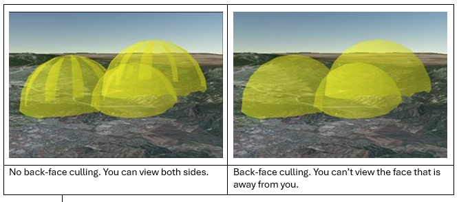

    Back-face culling determines whether the material is visible when projected onto the screen.
    Back-face culling
