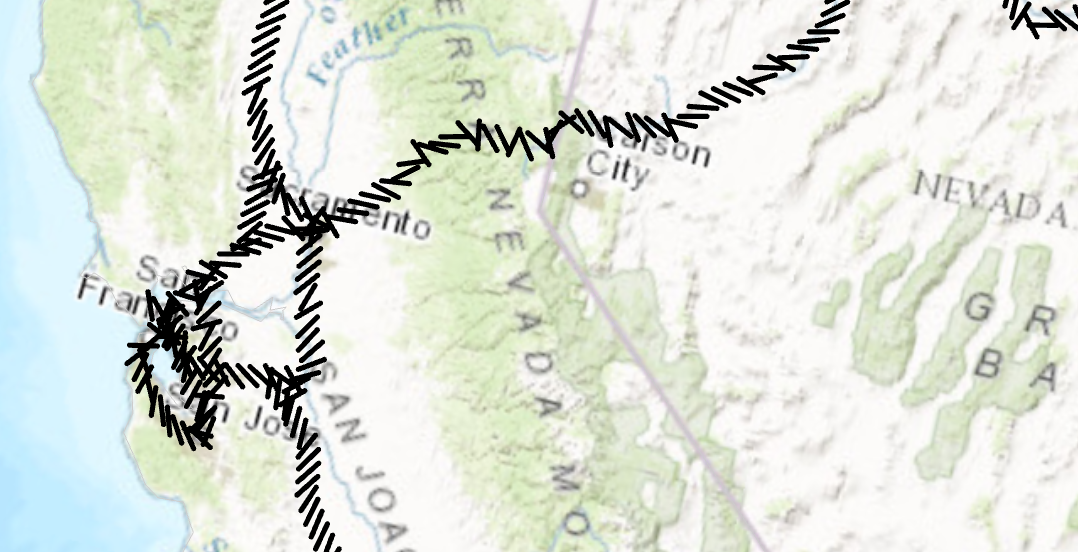

    Markers placed at a 45 degree angle
    /// <summary>
    /// Create a line symbol with the markers placed at a 45 degree angle. <br/>
    /// ![LineSymbolAngleMarker](https://ArcGIS.github.io/arcgis-pro-sdk/images/Symbology/line-marker-angle.png)
    /// </summary>
      //Create a line symbol with the markers placed at a 45 degree angle.
      //Create a marker from the "|" character.  This is the marker that will be used to render the line layer.
      //Note: Run withing QueuedTask
      var lineMarker = SymbolFactory.Instance.ConstructMarker(124, "Agency FB", "Regular", 12);
      //Default line symbol which will be modified
      CIMLineSymbol lineSymbolWithMarkersAtAngle = SymbolFactory.Instance.ConstructLineSymbol(ColorFactory.Instance.BlackRGB, 2, SimpleLineStyle.Solid);
      //Modifying the marker to align with line
      //First define "markerplacement"
      CIMMarkerPlacementAlongLineSameSize markerPlacement = new CIMMarkerPlacementAlongLineSameSize()
        AngleToLine = true,
        PlacementTemplate = new double[] { 5 }
      //assign the markerplacement to the marker
      lineMarker.MarkerPlacement = markerPlacement;
      //angle the marker if needed
      lineMarker.Rotation = 45;
      //assign the marker as a layer to the line symbol
      lineSymbolWithMarkersAtAngle.SymbolLayers[0] = lineMarker;
