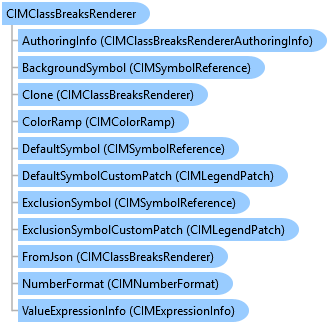

    Object Model
    CIMClassBreaksRenderer ClassCIMClassBreaksRendererAuthoringInfo ClassCIMSymbolReference ClassCIMClassBreaksRenderer ClassCIMColorRamp ClassCIMSymbolReference ClassCIMLegendPatch ClassCIMSymbolReference ClassCIMLegendPatch ClassCIMClassBreaksRenderer ClassCIMNumberFormat ClassCIMExpressionInfo Class
