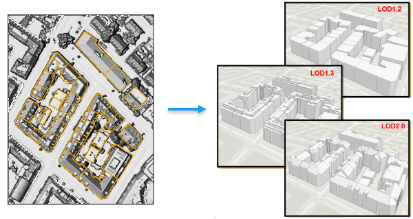

Illustration
Extract LOD2 Buildings tool illustration
This data is courtesy of the City of Zurich.

  • The characteristics of the output building models are described by the Levels of Detail (LOD) concept in the CityGML standard. The tool supports the generation of LOD 1.2, LOD 1.3, and LOD 2.0. LOD 1.x models using a flat representation of the roof; LOD 2.x models capture the slope and directional orientation of the roof.

  • LOD1.2—The building rooftop will be represented as a flat roof with larger elements being modeled at the median height of the entire building.
  • LOD1.3—The building rooftop will be represented as a flat roof with larger elements being modeled at the median height of the element.
  • LOD2.0—The slope and directional orientation of the building rooftop and its larger elements will be represented. This is the default.
