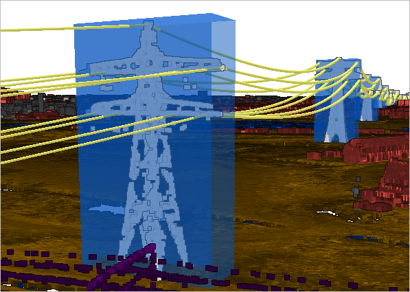

Extract Objects From Point Cloud (3D Analyst Tools)
Summary
Extracts distinct objects from a classified point cloud into point, polygon, or multipatch features.
Illustration
Extract Objects From Point Cloud tool illustration
