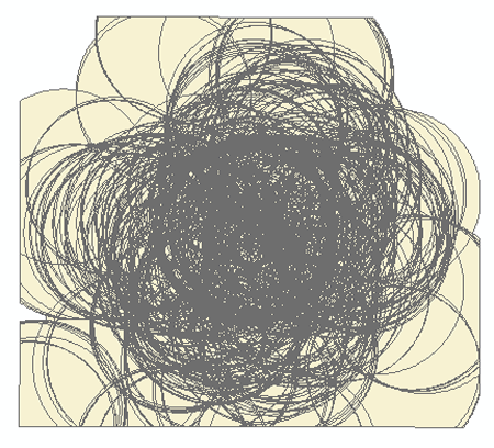

Areas of massive overlap
Complex Intersect tool output example
Areas of massive overlap of lines and polygons can impede the performance of classic core overlay tools.
In the case of densely packed buffer output polygons, the buffer polygons may overlap to a point where selecting a single area in the data returns a selection of tens or even hundreds of thousands of buffer features. For core overlay tools such as Intersect or Erase, the determination of every unique polygon created from all this overlap is costly. The pairwise overlay tools may be better choices for this scenario.
In the case of densely packed intersecting lines, every point of intersection and overlap is determined up front by the classic overlay tools (Intersect, Erase, and Clip to some extent). This can be costly in severe cases. The pairwise overlay tools may be better choices for this scenario.
If your analysis relies on finding every instance of overlap (such as when using the Intersect or Union tools), you must use the classic overlay tools. However, if your tens of thousands or hundreds of thousands of input features result in an output of hundreds of millions of output features representing each unique incident of overlap, you may need to rethink your approach to make sense of the results of the overlay operation. A reevaluation of the goal of your analysis may reveal that a different scale of size and scope can help you better understand the outcome of the analysis. Breaking up the data into more reasonable areas of interest may improve the performance of classic overlay tools when the overlap of the input features is extreme.
