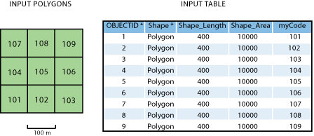

Use a field with unique values for every individual polygon
To find the neighbors of each individual polygon in the input, specify an input field that has a unique value for every polygon. In this example, the input table of the nine polygons has a myCode field, which has a unique value for each polygon.
Input data
The table below shows the result of using the myCode field as the Report By Fields parameter value. The prefixes in the source and neighbor field names are src_myCode and nbr_myCode.
Output table

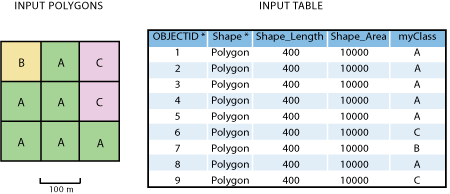

Use a field with values defining unique polygon groups
To identify unique polygon groups and report the neighboring information by the groups, specify a field that has unique values of the classification. The neighboring information is summarized based on how the unique groups are related. In this example, the unique polygon groups are identified using the myClass field as the Report By Fields parameter value.
Input data
The following is the result of using the myClass field as the Report By Fields parameter value:
  • For group A to other polygons of group A, the total length of coincident edges is 1200, which comes from the six coincident edges among the polygons in group A.
    Note:
    The output table will only contain a unique record for each unique combination of source and neighbor polygon values specified using the Report By Fields parameter. Since group A is used as the source and the neighbor as one side of the relationship, and the reversed relationship is also group A as the source and the neighbor, the total of both sides of the neighbor relationship are in one record.
  • Between group A and group B, there are only two edges that are coincident for a total length of 200. This is also the case between group B and group A.
  • Between group A and group C, there are three coincident edges for a total length of 300. This is also the case between group C and group A.
  • For group B to other polygons of group B, unlike group A, no neighboring relationship was found, so there is nothing reported in the output.
Output table

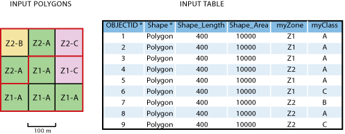

Use multiple fields with combined values defining unique polygon groups
In this example, the values in the myZone field represent one classification of the polygons, and the values in the myClass field represent a second classification.
Input data
When two fields, myZone and myClass, are specified as the Report By Fields parameter value, the combined values of the two fields will result in the following unique polygon groups:
  • Z1-A group
  • Z1-C group
  • Z2-A group
  • Z2-B group
  • Z2-C group

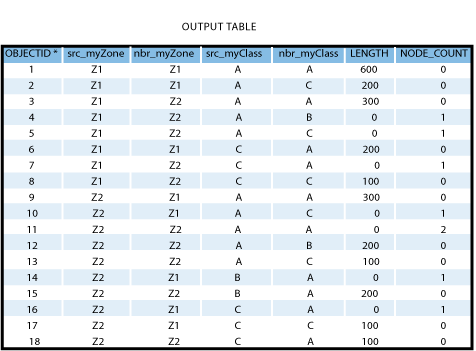

The output table below shows the neighboring information for these groups. The first eight rows represent the unique groups of Z1 values combined with the values in the myClass field being the source groups and their neighboring groups in Z1 and Z2.:
  • The Z1-A source group has six coincident edges within the group (similar to group A in the previous example), and the total length of coincident edges is 600.
  • The Z1-A source group is an edge neighbor with the Z1-C neighbor group, and the total length of coincident edges is 200.
  • The Z1-A source group is an edge neighbor with the Z2-A neighbor group, and the total length of coincident edges is 300.
  • The Z1-A source group is not an edge neighbor with the Z1-B neighbor group, but the Z1-B neighbor group boundary touches the Z1-A source group at a node and is a node neighbor. Consequently, the value for the LENGTH field is 0, and the value for the NODE_COUNT field is 1.
Output table

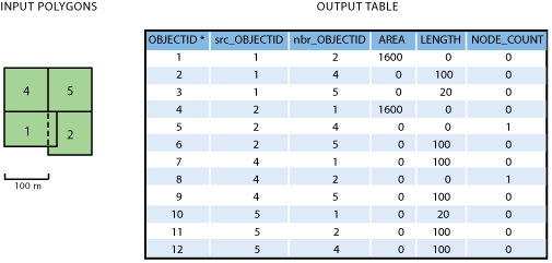

The Include area overlap parameter is checked
Using polygon 1 as the source polygon for an example, three neighbor polygons are found, and the following information is reported in the output table below when the Include area overlap parameter is checked:
  • Polygon 2 overlaps polygon 1, and the area of overlap, 1600, is written in the AREA field. The analysis of edge and node neighbors is skipped even though polygon 2 has a coincident edge with polygon 1 and crosses it at a point. The LENGTH and NODE_COUNT fields have a value of 0.
  • Polygon 4 has a coincident edge with polygon 1, and the coincident length of the edge, 100, is written in the LENGTH field.
  • Polygon 5 has a coincident edge with polygon 1, and the length of the coincident edge, 20, is written in the LENGTH field. The node neighbor analysis is skipped even though it crosses polygon 1 at a point (the Pairwise Polygon Neighbors tool only uses touches so this cross situation is not considered). The NODE_COUNT field has a value of 0.
Input data and output table
