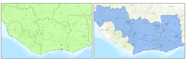

    Polygons returned with point features
    The input point and polygon features are shown in the first image and the resulting area features from the Aggregate Points tool are shown in the second image.
