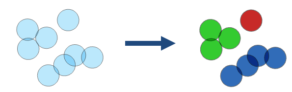

Illustration
Group By Proximity tool illustration

  • The output result is a copy of the input with a new field named group_id. The group_id field represents the grouping of features. Features with the same group_id value are in the same group. The group numbers represent membership in a particular group and don't imply value. The group numbers may not be sequential or the same number in repeat use of the tool. Results will be symbolized with eight groups. If there are more than eight groups in the result, all groups will be symbolized with eight colors by default. You can modify the symbology to show each unique group by symbolizing with unique symbols on the group_id field.
