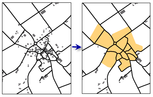

Illustration
Delineate Built-Up Areas tool example
The Delineate Built-Up Areas tool creates polygons that represent the distribution of input building features.
