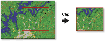

Clip Raster (Data Management Tools)
Summary
Cuts out a portion of a raster dataset, mosaic dataset, or image service layer.
Illustration
Clip Raster tool illustration
Usage
  • This tool allows you to extract a portion of a raster dataset based on a template extent. The clip output includes any pixels that intersect the template extent. To extract a portion of a feature dataset, use the Clip tool in the Analysis toolbox.
  • The clipped area is specified either by a rectangular envelope using minimum and maximum x- and y-coordinates or by using an output extent file. If the clip extent specified is not aligned with the input raster dataset, this tool verifies that the proper alignment is used. This may cause the output to have a slightly different extent than specified in the tool.
  • An existing raster or vector layer can be used as the clip extent. If you are using a feature class as the output extent, you can clip the raster by the minimum bounding rectangle of the feature class or by the polygon geometry of the features. If clipping geometry is used, the pixel depth of the output may be promoted. Ensure that the output format can support the proper pixel depth.
  • You can also use the selected features within the display as the clipping extent. If a feature in the feature class is selected and the Use Input Features for Clipping Geometry parameter is checked, the output clips out the selected areas. If a feature in the feature class is selected but the Use Input Features for Clipping Geometry parameter is not checked, the output clips out the minimum bounding rectangle for that feature.
  • You can interactively draw a polygon on the raster in the map to be used as the clipping extent. Click the Create new features in the current map to use as input drop-down list and click Polygon. Then move the pointer to the map to digitize a polygon. Double-click to complete the clipping polygon.
