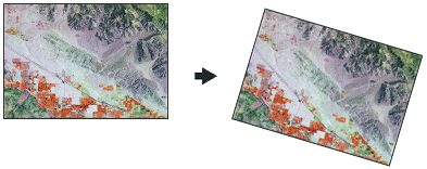

Turns a raster dataset around a specified pivot point.
Illustration
