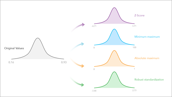

Illustration
Standardize Field tool illustration
Standardize the values of a field using one of four methods.
