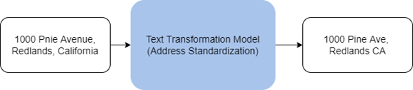

Text transformation model flow chart
A text transformation model for address standardization can correct spelling mistakes and standardize street addresses.

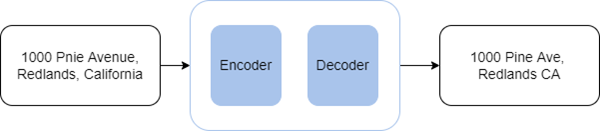

Internally, text transformation models in ArcGIS are encoder-decoder models. The encoder’s attention layers receive all the words in the input text, but the decoder’s attention layers can only access the words before the word being processed. The decoder then turns the encoded feature representations to produce the output sequence of tokens. Some well-known encoder-decoder models are BART and T5.
Encoder and decoder are described as follows:
  • Encoder—The encoder transforms the input text to a numerical representation in the form of fixed-length feature vectors. This numerical representation retains the semantic meaning of the input text.
  • Decoder—The decoder takes the encoded feature vectors from the encoder and combines them with the input sequence to produce an output sequence of tokens.
