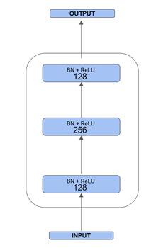

The FCN time series model uses three 1D convolution layers without striding and pooling. Average pooling is done at the last layer of the architecture. After every convolution, batch normalization is performed and rectified linear units (ReLUs) are used asactivation functions. The network architecture is depicted as follows:
FCN architecture
Fully Convolutional Network architecture for Time Series Forecasting is shown.

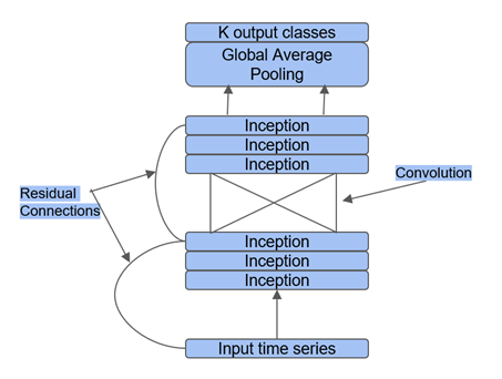

This CNN (convolutional neural network) is based on the previously proposed Inception network "Going Deeper with Convolutions" (2015) [1] for image classification. Before InceptionTime, the computational power of neural networks was based on their depth. The inception module proposed in this paper uses various convolutions in parallel and concatenates their output, thereby increasing both the depth and width of the network, while keeping the computational budget constant.
The InceptionTime model applies this architecture for Time Series Forecasting. In this model, the concatenation is done for one-dimension convolution layers of kernel sizes of length 10, 20, and 40, and a max pooling layer of size 3. Also, a residual connection is introduced at every third inception module, as shown in the following figure. The Inception network also makes heavy use of bottleneck layers, where filters of length 1 and stride 1 are used to reduce the dimensionality of the time series as well as the model complexity, while preventing overfitting. Multiple such inception blocks are used in the network followed by a global average pooling layer.
InceptionTime architecture
InceptionTime architecture for Time Series Forecasting is shown.

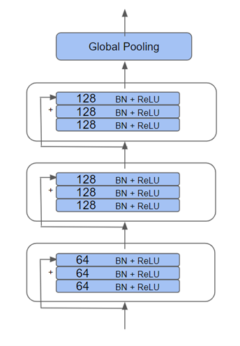

Conventional wisdom with deep neural networks is that the deeper the network is, the better it should perform, as there are more parameters to learn complex tasks. However, it was observed that the model performance actually gets degraded with more depth due to the problem of vanishing gradients. To solve this problem, residual block was introduced in the ResNet architecture. This model is composed of residual blocks, in which skip connections, or shortcut connections, are added. These direct connections allow gradient to flow unhindered to earlier layers of the network along them to learn better.
For Time Series Forecasting, the architecture is adapted in the "Time Series Classification from Scratch with Deep Neural Networks: A Strong Baseline" paper by Wang et. al. 2016. The network uses three residual blocks, as shown in the following figure. Each block contains a combination of three convolutions with batch normalization and uses ReLU as the activation function. Skip connections are added at input and output. The filter sizes used here are of length 64,128, and 128, respectively, and the last layer uses global average pooling.
ResNet Architecture
ResNet architecture for Time Series Forecasting is shown.

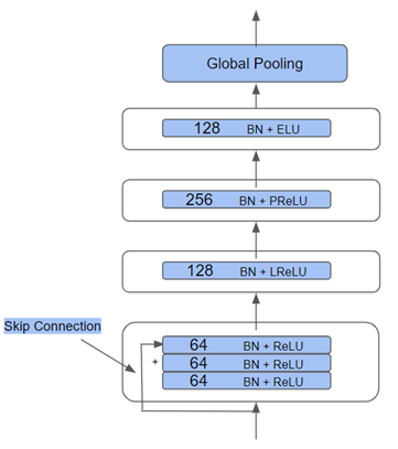

ResCNN
This network is a combination of ResNet and convolution neural networks. A single skip connection is added to the network for better information transfer. To solve overfitting due to skip connections in all the residual blocks, this architecture uses skip a connection in the first block only, as shown in the following figure. Diversified activation functions, including ReLU, LReLU, PReLU, and ELU, are used at different layers to achieve a decent abstraction [2].

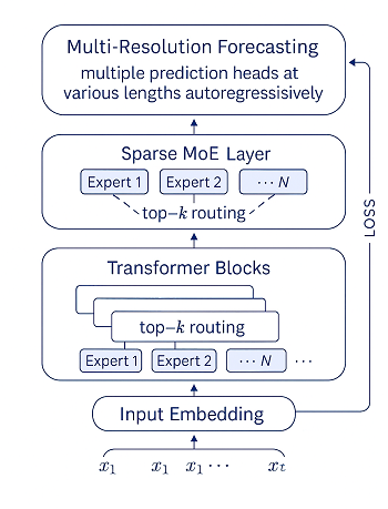

The Time-MoE architecture is a scalable, decoder-only transformer framework designed specifically for time series forecasting. It incorporates a Mixture-of-Experts (MoE) mechanism, where only a subset of its large parameter space is activated during inference, enabling efficient computation and specialization across diverse forecasting tasks. The model supports long input sequences (up to 4,096 time steps) and arbitrary prediction horizons, making it highly flexible. It uses gated MLP-based input embeddings tailored for time series data and rotary positional embeddings (RoPE) for temporal encoding. The architecture is fully trainable, allowing researchers and practitioners to fine-tune it on domain-specific datasets or train it from scratch, offering full control over model design, expert routing, and training configurations.
TimeMoE architecture
TimeMoE architecture for Time Series Forecasting is shown.

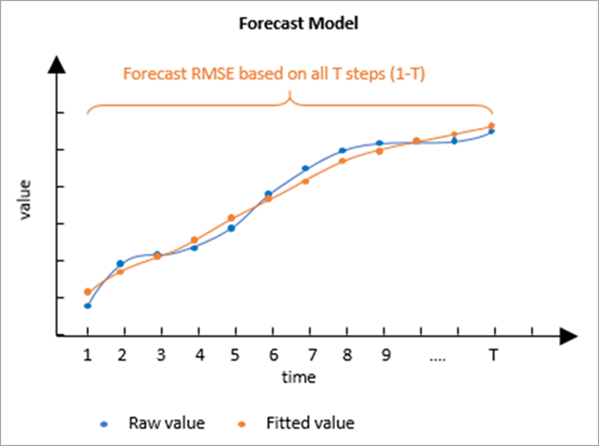

    The following image shows the raw values of a time series along with the values learned by the time series model. The Forecast RMSE measures how much these two time series differ.
    Forecast Model
    The Forecast RMSE only measures how well the curve fits the raw time series values. It does not measure how well the trained model forecasts future values. It is common for a model to fit a time series closely but not provide accurate forecasts when extrapolated, and hence validation RMSE is a more reliable metric.
