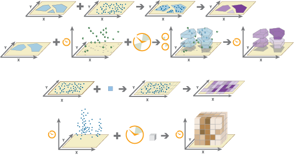

Illustration
Aggregate Points tool illustration
Examples of aggregating points into polygons (first row), time-enabled points into polygons with time stepping (second row), points into bins (third row), and points into bins with time stepping (fourth row) are shown.
