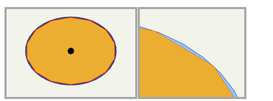

GeoAnalytics Desktop tools result in less densified features than other ArcGIS Pro tools. For example, the images below depict the result of vertices on a buffered polygon using Buffer in the Analysis toolbox (blue), and Create Buffers in the GeoAnalytics Desktop toolbox (orange). The first image shows the buffered polygons overlayed on each other, and the second image shows a zoomed-in view of some of the polygon vertices.
