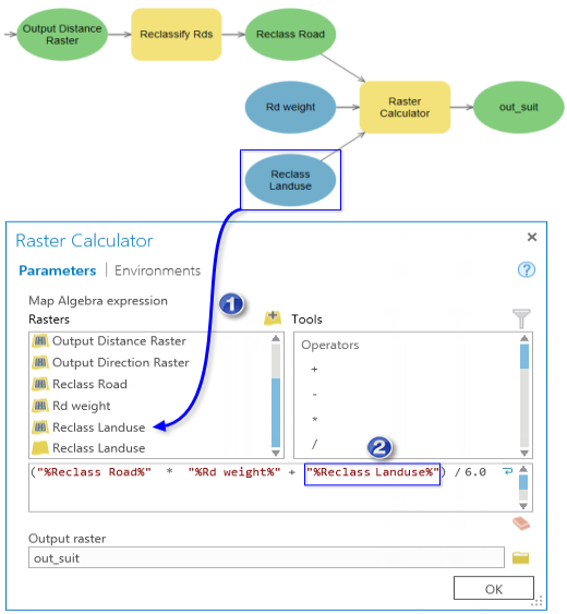

  • In this example, Raster Dataset Variable, a Long Variable, and a Raster Layer are being used.
    Notice that the different variables have slightly different syntax:
    Variable or layer name
    Variable type
    How syntax first appears in the expression
    Reclass Road
    "%Reclass Road%"
    Rd weight
    Long Variable
    %Rd weight%
    Reclass Landuse
    Raster Layer
    "Reclass Landuse"

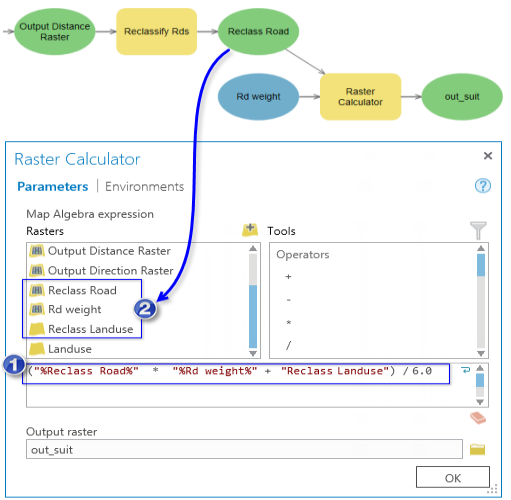

    To have inputs added with the correct syntax, complete the following steps:
    1. Place the pointer at the appropriate location in the expression box.
    2. Double-click the appropriate layer.
    Raster Calculator tool with expression using variables and layers
    The Raster Calculator tool with a simple expression using variables and layers is shown.
  • After clicking OK to close the Raster Calculator tool dialog box, a variable representing the Reclass Landuse layer will be added to your model as a model variable.
  • When the Raster Calculator tool dialog box is reopened, be aware of the following:
    • The Reclass Landuse variable is added to the list.
    • The syntax in the expression has been updated from the layer syntax ("Reclass Landuse") to the variable syntax ("%Reclass Landuse%").
    An example of the Raster Calculator tool with an expression using variable syntax is shown.
