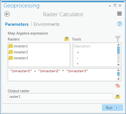

The Raster Calculator tool runs map algebra expressions. The tool has a calculator interface from which most map algebra statements can be created by clicking buttons. This tool can be used as a stand-alone tool, and it can also be used in ModelBuilder. As a result, the tool allows map algebra to be integrated into ModelBuilder.
Raster Calculator tool user interface
In the expression above, three rasters are combined by multiplying the second and third rasters, and adding that result to the first. Operators follow a defined order of precedence.
The Raster Calculator tool is not intended to replace other Image Analyst or Spatial Analyst tools. Continue to use the other tools for the appropriate calculations. For example, use the Weighted Sum tool to overlay several weighted rasters. The Raster Calculator tool is designed to run single-line algebraic statements.

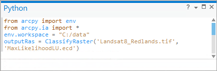

Python window example
In the sequence of statements above, the ArcPy site package, geoprocessing environments, and Image Analyst modules are imported, the workspace is set, and the Classify Raster tool is run. Once a carriage return is entered at the end of a statement, that statement is immediately run.
Some features of the Python window include built-in line autocompletion, use of variables, and access to Python and ArcPy functionality.
