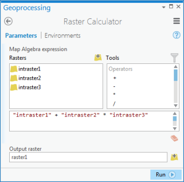

Raster Calculator tool in the Geoprocessing pane
Raster Calculator tool in the Geoprocessing pane with a simple expression
