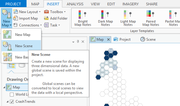

  1. After running the Emerging Hot Spot Analysis or Local Outlier Analysis tools (this example uses Emerging Hot Spot Analysis results), insert a New Scene.
    Insert a New Scene

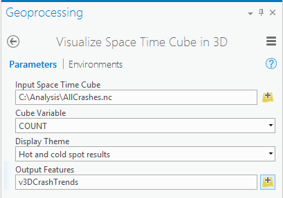

  2. In the Scene view, run the Visualize Space Time Cube in 3D tool (or use the Space Time Cube Explorer Add-in), pointing to your existing .nc cube containing the analysis results on disk.
    tool

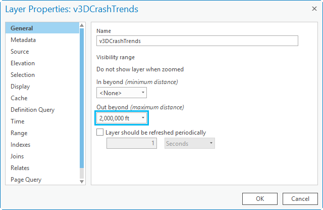

    You may need to increase or clear the Visibility range by right-clicking the layer in the Contents pane and selecting Properties, which opens the Layer Properties window.
    Increase the Visibility range

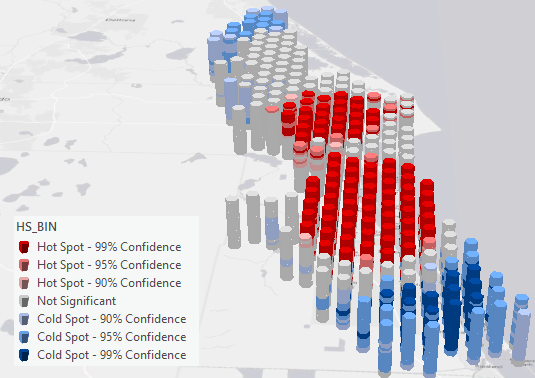

    Your 3D results should look something like this:
    Visualize Space Time Cube in 3D results

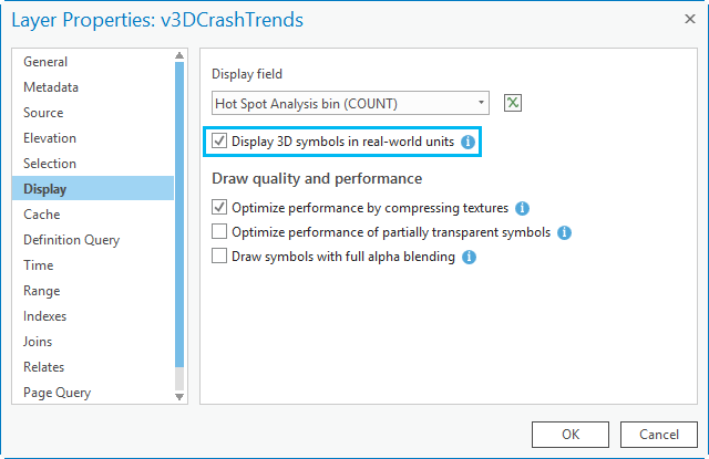

  4. Right-click the layer in the Contents pane, select Properties and click Display. Check the Display 3D symbols in real-world units check box. For Display field, choose Hot Spot Analysis bin (COUNT). The Layer 3D to Feature Class tool (step 6) will not work unless the layer is using real-world units.

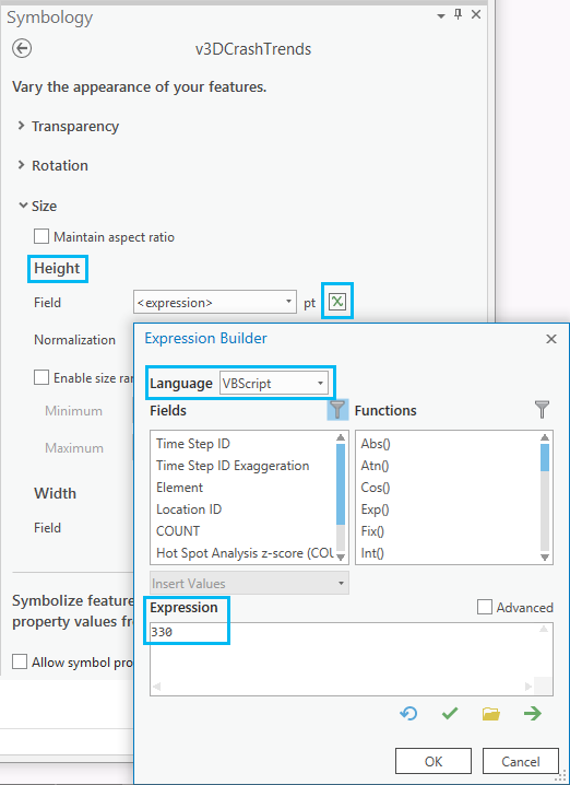

  5. Right-click the layer and select Symbology. In the main Symbology pane (with Unique Values in the drop-down on top) click the menu button and select Vary symbology by attribute. Expand Size if necessary. Clear the Maintain aspect ratio check box. The Height and Width options control the height and width of each bin. To optimize visualization of your cube, these values can be adjusted. This example uses a Height expression of 330 and a Width expression of 1800, but you can experiment to find optimal settings for your data. (Click the set expression button to the right of the Height and Width fields to enter an expression). These values will be specific to the size of your space-time cube and the number of time slices it represents. You will want to make sure the settings leave a little vertical gap between the space-time bins.
    Set Height and Width symbology expressions

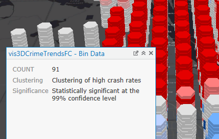

  8. Right-click the feature class you just created and select Configure Pop-ups. In the following screen capture, the title has been changed to Bin Data and set to only display the count, clustering, and significance fields.
    Configure pop-ups
