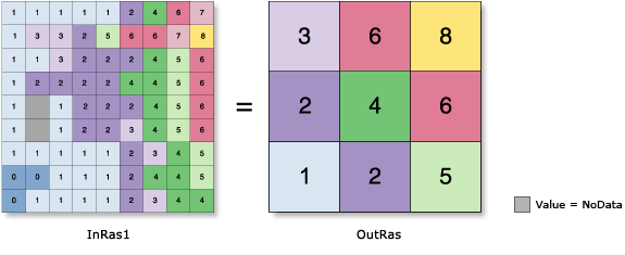

Generates a reduced-resolution version of a raster. Each output cell contains the Sum, Minimum, Maximum, Mean, or Median of the input cells that are encompassed by the extent of that cell.
For the Aggregation technique settings of Maximum, Minimum, or Sum, the output raster type will be the same as that of the input raster. If the setting is Mean or Median, the output type will always be float.
The geoprocessing analysis environments Extent and Cell size are recognized by this tool. To determine the output raster's resolution when an integer cell size has been specified, multiply the cell resolution of the analysis environment by the input cell factor parameter. If the cell size for the analysis environment is set to the minimum or maximum of the inputs, the resolution of the output raster will be the product of the input raster's resolution multiplied by the specified cell factor.
The factor by which the cell size of the input raster will be multiplied. The value must be an integer greater than 1.
For example, a cell factor value of 3 results in an output cell size three times larger than that of the input raster.
