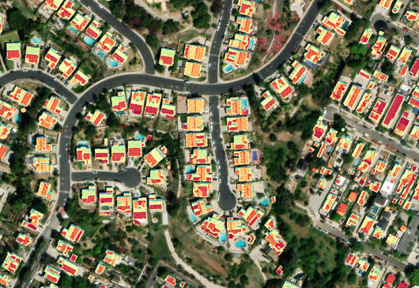

Raster solar radiation analysis for building rooftops
The raster solar radiation output computed on a DSM calculates solar radiation values only for building rooftops that were defined by an input analysis mask of building footprints.

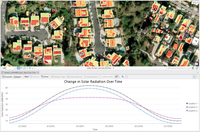

The following screenshot shows an example of solar radiation received by building rooftops and a graph with the amount of solar radiation over time for three locations.
A visualization and analysis of multidimensional raster data
Solar radiation for time intervals creates multidimensional raster data, which allows you to explore the amount of solar radiation for a time slice.
