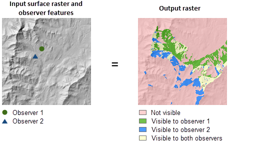

Illustration
Observer points illustration
Observer points output displayed on a hillshaded elevation surface
