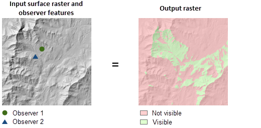

Illustration
Viewshed illustration
Viewshed output displayed on a hillshaded elevation surface
