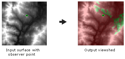

In the example below, the viewshed from an observation tower is identified. The elevation raster displays the height of the land (lighter shades represent higher elevations), and the observation tower is marked as a green triangle. The height of the observation tower can be specified in the analysis. Cells in green are visible from the observation tower, while cells in red are not.
Viewshed example
Using the transparency slider, you can display a hillshade raster layer underneath your elevation raster and incorporate the output from viewshed analysis for visualizing the relationship between visibility and terrain.
Displaying viewshed with hillshade
Not only can you determine which cells can be seen from the observation tower, but if you have several observation points, you can also determine which observers can see each observed location. Knowing which observer can see which locations can affect decision making. For example, in a visual quality study for siting a landfill, if it is determined that the proposed landfill can only be seen from dirt roads and not from the primary and secondary roads, it may be deemed a favorable location.

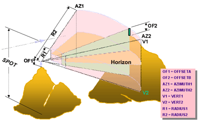

Controlling the visibility analysis
It is possible to limit the region of the raster inspected by specifying various items in the feature attribute dataset, such as observation point elevation values, vertical offsets, horizontal and vertical scanning angles, and scanning distances. There are nine items in total: SPOT, OFFSETA, OFFSETB, AZIMUTH1, AZIMUTH2, VERT1, VERT2, RADIUS1, and RADIUS2.
The image below graphically depicts how a visibility analysis is controlled. The observation point is on the mountain top to the left (at OF1 in the image). The direction of the viewshed is within the cone looking to the right. You can control how much to offset the observation point (for example, the height of the tower), the direction to look, and how high and low to look from the horizon.
Parameters for controlling the viewshed analysis
When the observer features dataset is a point feature class, each observation point can have a unique set of observation constraints in the attribute table. When it is a polyline feature class, every vertex along an input polyline uses the same observation constraints contained in the polyline's record in the attribute table.
The definitions for these items can vary as long as they are numeric. Whenever an item does not exist, the default values are applied.
SPOT
The SPOT item is used to define the surface elevations for the observation points.
Offset
The offset is the vertical distance (in surface units) to be added to the z-value of a location on the surface.
There are two offset items, one defining the elevation to be added to the observer location and the other defining what will be added to each cell to be considered for visibility.
Visibility offset
OFFSETA
The OFFSETA item indicates a vertical distance in surface units to be added to the z-value of the observation point.
If OFFSETA exists in the feature attribute table, its value is added to the SPOT elevation when present; otherwise, it is added to the interpolated surface z-value. The OFFSETA value must be positive. If the OFFSETA item does not exist, the default value is 1.
OFFSETB
The OFFSETB item indicates a vertical distance in surface units to be added to the z-value of each cell as it is considered for visibility.
If OFFSETB exists in the feature attribute table, its value is added to the surface z-value of each cell location when it is being analyzed for visibility. The value must be positive. If no OFFSETB item is found in the feature attribute table, it defaults to 0.
Azimuth
The azimuth items define the horizontal angle limits to the scan. The sweep proceeds in a clockwise direction from the first azimuth to the second. The values for the angle are given in degrees from 0 to 360, with 0 oriented to north.
Visibility azimuth directions
AZIMUTH1
The AZIMUTH1 item defines the start angle of the scan range.
If this item does not exist in the feature attribute table, it defaults to a value of 0.
AZIMUTH2
The AZIMUTH2 item defines the end angle of the scan range. The value for AZIMUTH2 must be greater than that of AZIMUTH1.
If this item does not exist in the feature attribute table, it defaults to a value of 360. If both AZIMUTH1 and AZIMUTH2 are not defined, the defaults will give a full 360° sweep.
Vertical angle
The vertical angle defines the vertical angle limits to the scan. The angles are expressed in degrees between 90 and -90, with positive values representing angles above the horizontal plane and negative angles below. The horizontal plane (0 degrees) is defined by the z-value of the observation point plus the value of OFFSETA. Both vertical angles can be negative.
Visibility vertical angle limits
VERT1
The VERT1 item defines the upper horizontal angle limit of the scan.
If this item does not exist in the feature attribute table, it defaults to a value of 90.
VERT2
The VERT2 item defines the lower horizontal angle limit of the scan. The value for VERT2 must be less than that of VERT1.
If this item does not exist in the feature attribute table, it defaults to a value of -90.
Radius
The radius items limit the search distance when identifying areas visible from each observation point. Cells that are beyond a certain distance can be excluded from the analysis.
Visibility radius
RADIUS1
The RADIUS1 item defines the start distance from which visibility is determined. Note that cells closer than the RADIUS1 search distance are not visible in the output raster, but they can still block the visibility of cells between RADIUS1 and RADIUS2.
The default RADIUS1 distance is 0.
RADIUS2
Cells beyond the RADIUS2 search distance are excluded from the analysis. The value for RADIUS2 should be greater than RADIUS1.
The default RADIUS2 distance is infinity.
Planimetric versus three-dimensional distance
By default, the limiting distances RADIUS1 and RADIUS2 are interpreted as three-dimensional line-of-sight distances. To ensure that the slope distance is calculated correctly, both the ground units and surface z-units must be in the same unit of measure. To process RADIUS1 and RADIUS2 as two-dimensional planimetric distances, insert a negative sign (-) in front of the values.
For example, if RADIUS1 is set to -1000 and RADIUS2 is set to -9000, Viewshed analyzes the regions of the surface between 1,000 and 9,000 ground units measured planimetrically from the observer.
