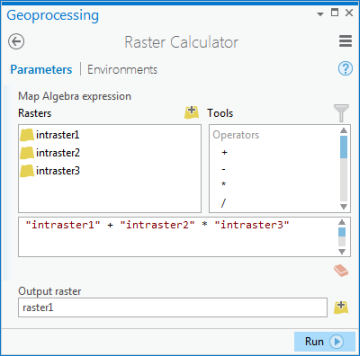

Raster Calculator tool in the Geoprocessing pane
Raster Calculator tool in the Geoprocessing pane with a simple expression

  • Use the Rasters list to choose the datasets and variables to use in the expression. The Tools list provides a selection of commonly used conditional and mathematical tools, allowing you to add them to the expression. Numerical values (and mathematical operator symbols) can be added to the expression directly.
  • Full paths to data or data existing in the specified current workspace environment setting can be entered in quotes (""). Numbers and scalars can be directly entered into an expression.
