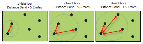

  • Given a set of features, this tool returns three numbers: the minimum, the maximum, and the average distance to a specified number of neighbors (N). Example: if you specify 8 for the Neighbors parameter, this tool creates a list of distances between every feature and its 8th nearest neighbor; from this list of distances it then calculates the minimum, maximum, and average distance.
    • The maximum value is the distance you would have to travel away from each feature to ensure every feature has at least N neighbors.
    • The minimum value is the distance you would travel away from each feature to ensure that at least one feature has N neighbors.
    • The average value is the average distance you would travel away from each feature to find its N nearest neighbors.
