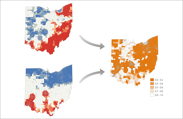

Illustration
Hot Spot Analysis Comparison tool illustration
Two hot spot analysis result layers are compared. Deeper shades of orange indicate the larger differences between the layers.
