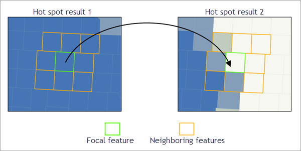

When comparing two corresponding features, the result can be more than simple binary (yes or no) of whether the features have the same significance level category. The calculations of similarity and association use fuzzy set membership to allow partial matches between corresponding features based on significance level similarity and spatial neighborhoods. For example, 99% hot spots can be considered perfect matches to other 99% hot spots, partial matches to 95% hot spots, and complete mismatches to 99% cold spots. Two corresponding features can also be considered partial matches based on distance similarity if the features do not have the same significance level, but their neighboring features do. The overall similarity between any two corresponding features is their categorical similarity multiplied by the distance similarity. See the Spatial fuzzy kappa section below for details about the calculations.

The Number of Neighbors parameter specifies the number of additional neighboring features that will be used in the comparisons, and partial similarity is incorporated using a distance weight based on the ordering of the neighbors. The feature receives a distance weight equal to 1, and the weights decrease consistently for each additional neighbor using the following formula:
\[ \text{Distance weight}=1-\frac{\text{Rank}} {\#\text{Neighbors} + 1} \]
The rank in the formula is the order of the neighbors and ranges from 0 (for the feature being compared) up to the number of neighbors (for the farthest neighbor). For example, with four neighbors (five, including the feature being compared), the following five distance weights are used: 5/5 (1), 4/5 (0.8), 3/5 (0.6), 2/5 (0.4), and 1/5 (0.2).

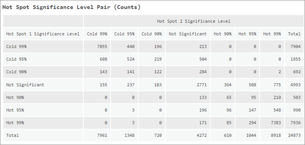

  • The Hot Spot Significance Level Pair (Counts) message table display counts of each hot spot significance level pair. For example, in the image below, the value 440 in the first row and second column means that 440 feature pairs were 99% cold in the first hot spot result and 95% cold in the second result. The row and column totals in the margins indicate the total counts of each significance level among each hot spot result.
    Hot Spot Significance Level Pair (Counts) messages

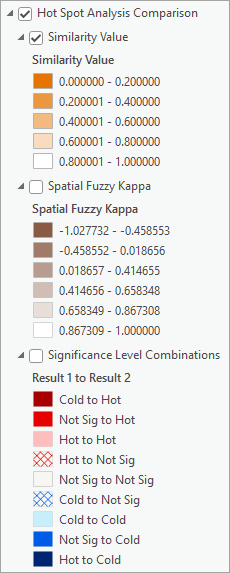

When the tool is run in a map, three layers will be added to a group layer that allow you to explore the similarity, association, and significance level pairs spatially. The first layer displays the similarity values classified into five equal intervals between 0 and 1, and lower similarity values are in darker colors to emphasize the areas that are most dissimilar. The second layer displays the spatial fuzzy kappa values symbolized with equal intervals and six classes. The third layer displays each significance level combination with custom symbology to identify features where one input hot spot result was a statistically significant hot spot and the other was a statistically significant cold spot (in the custom symbology, 90%, 95%, and 99% significance is not distinguished in order to reduce the number of combinations). By default, the first layer is enabled and the last two are disabled.
Group layer of comparison results

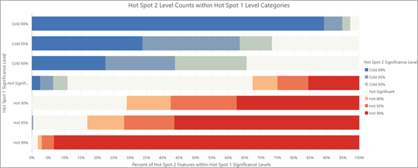

The Hot Spot 2 Level Counts within Hot Spot 1 Level Categories bar chart displays stacked horizontal bars to visualize the counts of each significance level category of the second hot spot result within the categories of the first result. For example, in the image below, the vast majority of 99% hot and cold spots were also significant hot and cold spots (the top and bottom bars are mostly blue and red, respectively). However, among nonsignificant features in the first result, there were more matching hot spots than cold spots in the second result (the middle bar has more red than blue). If the two hot spot result layers represent temperatures measured at different times, this may indicate a general warming of the study area between the measurement times.

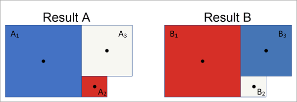

For example, the image below shows two hot spot results, A and B. A and B each have three features: one hot spot (red), cold spot (blue), and nonsignificant feature (light gray). The largest polygons are the first feature pair, the smallest polygons are the second feature pair, and the medium polygons are the third feature pair. The centroids of the polygons are shown to help determine which polygons are closer than others; the first polygon is slightly closer to the second polygon than it is to the third polygon.
Similarity calculation example
For this example, assume that the category weight between matching categories (hot to hot, cold to cold, and nonsignificant to nonsignificant) is 1, the weight between hot and cold spots is 0, and nonsignificant features have weight 1/2 with both hot and cold spots.
The following table shows the category weights, distance weights, and similarity of the directional similarity from the result A to result B. The similarity value in the last column is calculated by multiplying the distance weight and category weight:

The largest similarity from result A to result B is 0.33, which occurs for two neighbor combinations. The following table shows the directional similarity from result B to result A.

The largest similarity from result B to result A is 0.67.
The local similarity value for the feature pair is the smaller of the two directional similarities (A to B and B to A), so the similarity value of the first feature pair is 0.33. The same procedure is also used to calculate the similarity value for the second and third feature pairs, and for this example, both have similarity values equal to 0.5. The global similarity value is the average of the similarity values of all feature pairs, and for this example, the global similarity value is 4/9 = 0.44.

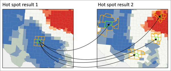

Random neighborhoods
Each feature of the first hot spot result is randomly paired with multiple features of the second result.
By comparing random neighborhoods, the expected value accounts for category frequency (more common categories are more likely to be randomly chosen) and category clustering within the neighborhoods (the random neighborhoods are likely to contain clusters of features with similar significance level categories). The similarity value from each random pairing is a single estimate of the similarity value under the assumption that the two hot spot results are independent. To calculate the expected similarity value of a feature, each feature of the first result is paired with many random neighbors, and the random similarity values are averaged. The Number of Permutations parameter specifies the number of random pairings for each feature. Larger numbers of permutations will increase the run time of the tool and increase the precision of the expected similarity and kappa values.
