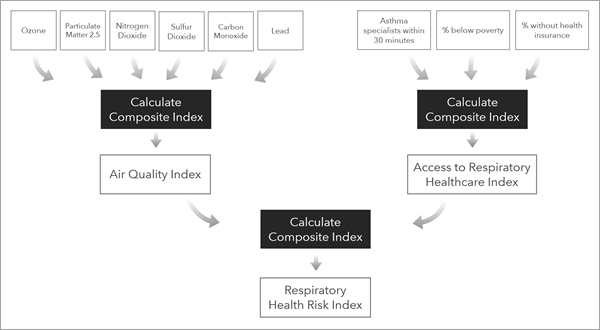

  • A public health department wants to create a respiratory health risk index to highlight environmental injustices. To do this, the analyst can run the Calculate Composite Index tool multiple times to create an index with multiple subindices, in which the first run of the tool creates subindices for different domains and the last run of the tool creates the final index.
    Combine subindices to a single index
  • A jurisdiction wants to apply for an infrastructure grant, and to qualify they need to prove that resources will go to underserved communities. They can create an index that combines infrastructure and demographic variables to identify the most underserved areas.

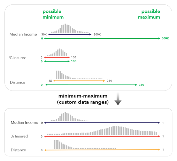

  • Minimum-maximum (custom data ranges)—This method scales the variables between 0 and 1 using the possible minimum and possible maximum values for each variable. This method is useful when the possible minimum and maximum do not exist in the range of the variable, or you want to create an index that must remain comparable as additional data is collected.
    Custom minimum-maximum scaling
    This method applies the following formula:
\[ x'= \frac{x - \text{specified\_min}} {\text{specified\_max} - \text{specified\_min}} \]
There are multiple use cases for setting a possible minimum and possible maximum:
  • When the index will be compared across time, and the current data does not represent the range of values that the index could have in other time periods.
    • When there is a reference statistic, such as a broader study area's minimum and maximum. For example, an index with a study area set in France may use a minimum and maximum based on all countries in Europe.
    • When there is an aspirational benchmark, such as the aspirational life expectancy in a human development index. While the data itself may not have the aspired life expectancy, the benchmark is still used to set context for the index.
    • When there is a priori knowledge of the theoretical minimum and maximum values for variables, such as knowing the absolute temperature ranges on Earth and using daily recordings with a smaller range.

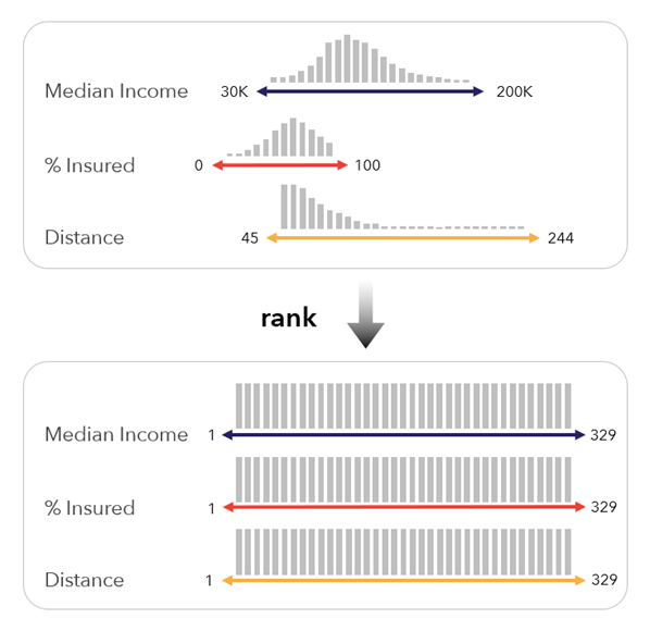

  • Rank—This method ranks the input values, assigning a value of 1 to the lowest value in the variable and incrementing by 1 for each value. This method can be useful when the ranks of each variable are more important than their actual values. The method is also robust to outliers and skewed distributions.
    Rank scaling
    The method uses the rank average method, which resolves ties by assigning the mean rank value to tied observations.
    This method is similar to percentiles, but the range of the values is between 1 and the number of records in the table.

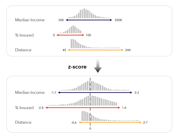

  • Z-score—This method standardizes each variable using the Z-score formula. This method is useful when each value should be considered with respect to the variable's mean. For example, when you want to know whether the percent of people below the poverty line is higher or lower than the national average, and by how much.
    Z-score scaling
    This method uses the following formula:
    \[ x' = \frac{x - \bar{x}}{\sigma_x} \]
    where \(x'\) is the z-score, \(x\) is the original value, \(\bar{x}\) is the mean (average), and \(\sigma_x\) is the standard deviation.
    Z-scores are expressed in standard deviations, a measure of dispersion in the data. A z-score of 2 means that the feature is two standard deviations greater than the mean, and a z-score of -1 is one standard deviation less than the mean. The method is less susceptible to adverse effects from outliers when compared with the minimum-maximum method. However, it produces negative values, making it incompatible with multiplicative combination methods.

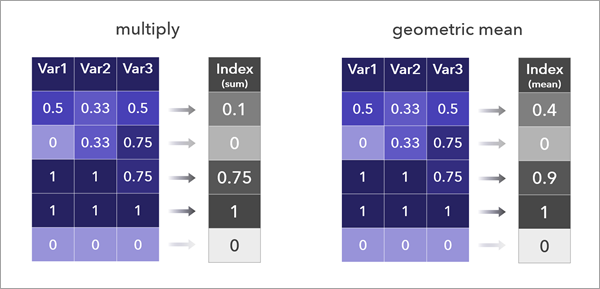

The Multiply and Geometric mean methods require more caution to use, as the resulting index values can be much higher than when using an additive method and the methods do not work well when using negative values.
Multiplicative combination methods
Despite their disadvantages, multiplicative methods have the advantage that they do not allow high values in one variable to compensate for low values in another variable; for an index value to be high, multiple variables must have high values.
Multiplicative methods do not compensate

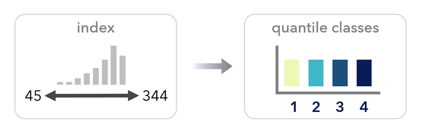

The quantile method divides the values into classes so that each class has the same number of features or rows. This method produces a similar map to the index percentile layer but uses classes, unlike the continuous percentile distribution. Use this option to create a map of quintiles (with five classes), deciles (with 10 classes), or other types of quantiles based on the number of classes.
Quantile classification

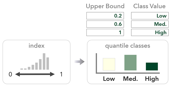

The custom classes method categorizes the continuous index using custom class bounds and custom labels. You can add numeric labels or text labels, such as Low, Medium, and High.
Custom classification

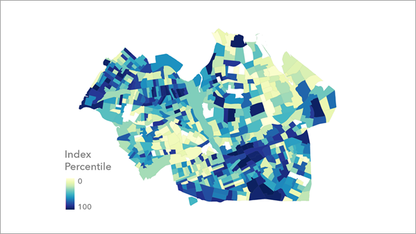

The index percentile layer displays the relative positions (ranks) between index values. The resulting map colors correspond to the ranks of the index values, so they do not preserve the distribution or any sense of actual index differences. Use this method when you want to evaluate how locations relate to each other based on their index rank.
Index percentile layer

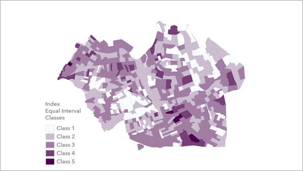

The index equal interval classes layer shows classes based on the index distribution of values, but it groups values together into classes based on equal intervals set by the Output Index Number of Classes parameter. This layer is a classified form of the index layer.
Index equal interval classes layer

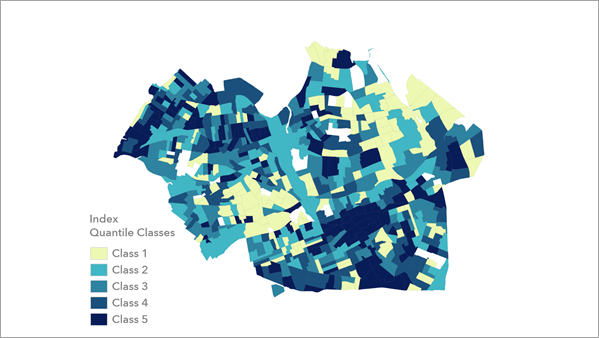

The index quantile layer assigns an equal number of features to each class and is a classified form of the index percentile layer. The number of classes are set by the Output Index Number of Classes parameter.
Index quantile layer

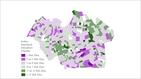

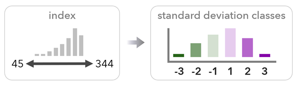

The index standard deviation classes layer visualizes locations above and below the index mean. The color scheme helps emphasize extremely high and low index values, which can be useful to identify locations that may need further investigation.
Index standard Deviation classes layer

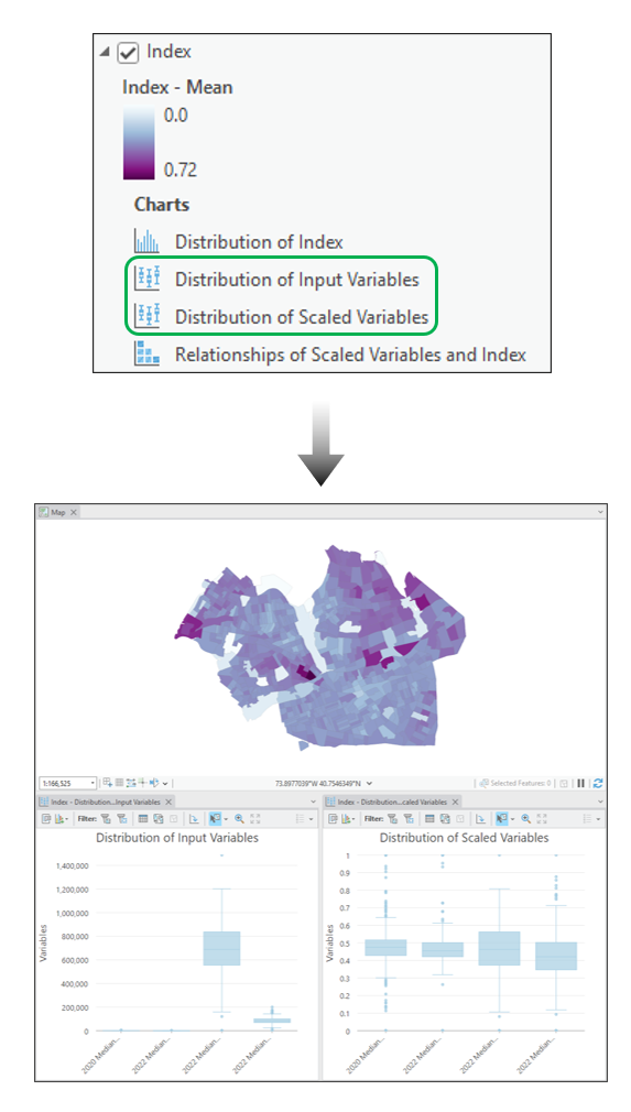

Explore the distributions of the input variables
The primary index layer contains two box plots of the input variables: one visualizing the variable distributions before scaling and one visualizing variable distributions after scaling. It is often useful to compare these charts side by side to evaluate how the selected scaling method changed the input variables. Comparing these charts side by side can help you evaluate whether the selected scaling method had the intended effect on the distribution of the variables.
Box plots of input and scaled variables
You can also use the box plots to investigate outliers by selecting the outliers on the box plot of input variables and confirming their location on the map. You can then view the box plot of preprocessed variables to verify whether the chosen preprocessing method has remediated the effect of the outlier.

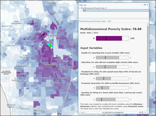

The feature layer includes pop-ups that visualize the values of the index and input variables for each feature. Use the Explore tool to click a feature, and use the pop-up to examine the results.
Pop-up of value and range of each index
The pop-up displays the value and range of the resulting index and each input variable. The black line in each bar indicates the mean across all features.

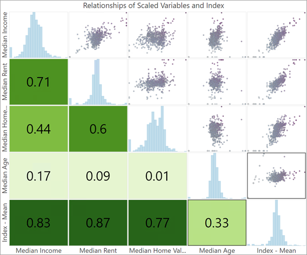

Explore which variables impact the index
The index layer includes a scatterplot matrix that displays the correlation between the index and each variable used. The variables with high correlation against the index will generally correspond to the variables that contributed most significantly to the index. Consequently, any variables with low correlation with the index may be considered to have less impact on the index. Additionally, consider whether any variables have low internal variation; variables with low variation are less likely to contribute meaningful information to your index.
Relationships of scaled variables and index
