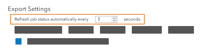

Job status refresh
The owner or administrator of the app can specify how often export jobs refresh their status. The default is 30 seconds. Acceptable values range from 1 second to 1,800 seconds.
Note:
A job's status will not refresh automatically if the value specified is zero seconds.
Option to configure automatic job status refresh

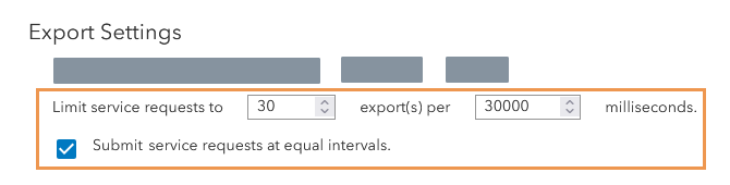

Service requests
Export jobs send a request to Topographic Production Service instances associated with the MPS app deployment. The amount of service requests must not exceed hardware capabilities. To help manage these requests, app administrators can configure the rate at which requests are accepted by the service. The count per interval can range from 1 to 1,000, and the interval value can range from 0 to 1,800 seconds. An interval of zero indicates no delay.
Note:
This is not the rate at which export jobs run or how long it takes to complete them. This setting modifies the rate at which requests to start export jobs are submitted.
Option to limit service requests
If the Submit service requests at equal intervals check box is checked, the amount of service requests specified are spread evenly across the time specified. If it is not checked, the number of service requests specified are submitted as a batch, and the time specified is the delay between submitted batches.
