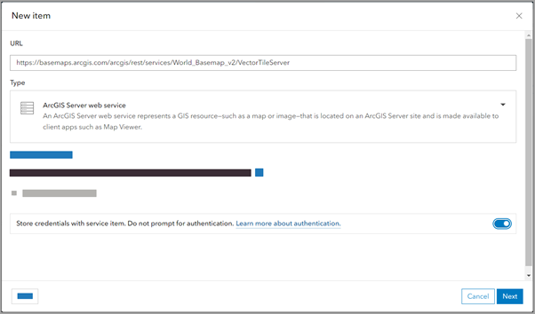

To use custom basemaps, an item must be created in the same Enterprise portal that contains the MPS app. The created item can reference the service URL of a custom basemap, which allows the service associated with the custom basemap to be secured using the service credentials stored with the item. To add an Esri-provided custom basemap for use with the MPS app, complete the following steps:
  1. In the portal hosting the MPS app, create an item from a service URL.
    New item dialog box with URL details
    Providers of non-Esri basemap services may make URLs available on their website.

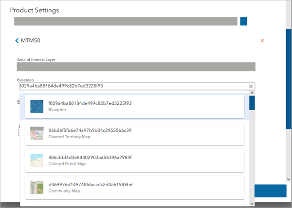

  7. In the General Settings section, check the Use portal-configured basemaps check box.
  8. Verify that the basemaps you shared to the group appear as options under Basemap for a map product in the Product Settings section.
    Product Settings Basemap options
The configured basemaps are available in the Basemap section for each map product. Only the basemaps that are shared with the basemap group appear. These are also the basemaps that will be available in the app.

  2. In the General Settings section, check the Use portal-configured basemaps check box.
  3. Verify that the basemaps you shared to the group appear as options under Basemap for a map product in the Product Settings section.
