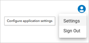

To access the app settings, complete the following steps:
  1. Sign in to the app as an administrator.
  2. Click the User button and click Settings.
    Profile menu with the Settings option highlighted
    The Map Production System dialog box appears with the app's settings.
