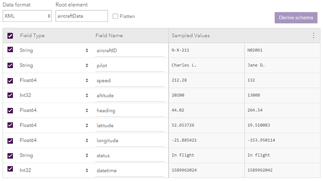

If a root element of aircraftData is specified, only the following data are ingested by Velocity:
<aircraftData>
    <aircraftID>N-X-211</aircraftID>
    <pilot>Charles L.</pilot>
    <speed>212.28</speed>
    <altitude>20200</altitude>
    <heading>44.02</heading>
    <latitude>52.653726</latitude>
    <longitude>-21.885421</longitude>
    <status>In flight</status>
    <datetime>1589962024</datetime>
  </aircraftData>
  <aircraftData>
    <aircraftID>N02061</aircraftID>
    <pilot>Jane D.</pilot>
    <speed>132.00</speed>
    <altitude>13008</altitude>
    <heading>264.54</heading>
    <latitude>19.510083</latitude>
    <longitude>-153.950114</longitude>
    <datetime>1589962042</datetime>
  </aircraftData>
The following example illustrates the schema derivation in Velocity:
Resulting confirm schema page with the aircraftData root element specified.

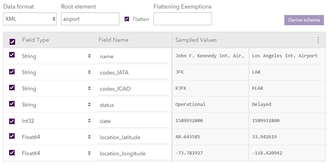

Flatten
The Flatten parameter determines whether any nested XML structures are broken into separate fields. These new fields are named by appending subelements with an underscore to the higher level, parent, or element. In the following example, the location element contains two subelements: latitude and longitude. If flattened, the location element is broken into two fields, location_latitude and location_longitude.
When flattening is applied, the XML can be nested with multiple levels of depth. The new flattened field names append object names with an underscore until reaching the deepest level subelement.
For example, consider the following sample XML, specifically the codes and location elements:
<?xml version="1.0" encoding="UTF-8"?>
<airportData>
  <airport>
    <name>John F. Kennedy Int. Airport</name>
    <codes>
      <IATA>JFK</IATA>
      <ICAO>KJFK</ICAO>
    </codes>
    <status>Operational</status>
    <date>1589932800</date>
    <location>
      <latitude>40.643585</latitude>
      <longitude>-73.781927</longitude>
    </location>
  </airport>
  <airport>
    <name>Los Angeles Int. Airport</name>
    <codes>
      <IATA>LAX</IATA>
      <ICAO>KLAX</ICAO>
    </codes>
    <status>Delayed</status>
    <location>
      <latitude>33.942619</latitude>
      <longitude>-118.420942</longitude>
    </location>
  </airport>
</airportData>
If airport is specified as the root element and the Flatten check box is checked, the sample XML above is processed as follows in which the codes and location subelements are broken into respective fields:
<airport>
    <codes_IATA>JFK</codes_IATA>
    <codes_ICAO>KJFK</codes_ICAO>
    <location_latitude>40.643585</location_latitude>
    <location_longitude>-73.781927</location_longitude>
  </airport>
  <airport>
    <codes_IATA>LAX</codes_IATA>
    <codes_ICAO>KLAX</codes_ICAO>
    <location_latitude>33.942619</location_latitude>
    <location_longitude>-118.420942</location_longitude>
  </airport>
The following example illustrates how the schema is ingested in Velocity:
Resulting confirm schema page from the flattened XML.

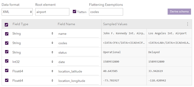

Flattening exemptions
The Flattening exemptions parameter allows you to specify one or more XML element names that are left as a single string element and not broken into separate fields.
Consider the following sample XML:
<airportData>
  <airport>
    <codes>
      <IATA>JFK</IATA>
      <ICAO>KJFK</ICAO>
    </codes>
    <location>
    </location>
  </airport>
  <airport>
    <codes>
      <IATA>LAX</IATA>
      <ICAO>KLAX</ICAO>
    </codes>
    <location>
    </location>
  </airport>
</airportData>
If airport is specified in the Root element parameter, the Flatten parameter is checked, and the Flattening exemptions parameter value of codes is specified, the sample XML above is treated as illustrated in the following example. Notice that the codes element is not broken up by flattening and IATA and ICAO are maintained as subelements.
<airport>
    <codes>
      <IATA>JFK</IATA>
      <ICAO>KJFK</ICAO>
    </codes>
  </airport>
  <airport>
    <codes>
      <IATA>LAX</IATA>
      <ICAO>KLAX</ICAO>
    </codes>
  </airport>
The following example illustrates schema ingested in Velocity:
Resulting confirm schema page from the flattened XML shows the codes field is exempted from flattening.

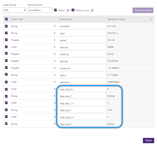

Flatten arrays
The Flatten arrays parameter specifies whether arrays are flattened into separate fields. New fields are named by appending the array element name with an underscore and the name of items in the array element. When flattening arrays of elements, the XML can be nested with multiple levels of depth. The new flattened field names append the number of array elements with an underscore until reaching the deepest element.
For example, the following sample XML shows the tags array element:
<flight>
  <aircraftData>
    <tags>
      <tag n="0">boeing</tag>
      <tag n="1">vtol</tag>
      <tag n="2">glider</tag>
    </tags>
  </aircraftData>
</flight>
If aircraftData is specified in the Root element parameter, and the Flatten and Flatten arrays parameters are checked, the sample XML above will be processed as follows. Notice the items in the tags element are divided into respective fields:
<flight>
  <aircraftData>
    <tags_tag_0_n>0</tags_tag_0_n>
    <tags_tag_0>boeing</tags_tag_0>
    <tags_tag_1_n>1</tags_tag_1_n>
    <tags_tag_1>vtol</tags_tag_1>
    <tags_tag_2_n>2</tags_tag_2_n>
    <tags_tag_2>glider</tags_tag_2>
  </aircraftData>
</flight>
The following example illustrates the schema ingested in Velocity:
Resulting confirm schema page shows the tags fields divided into separate fields.

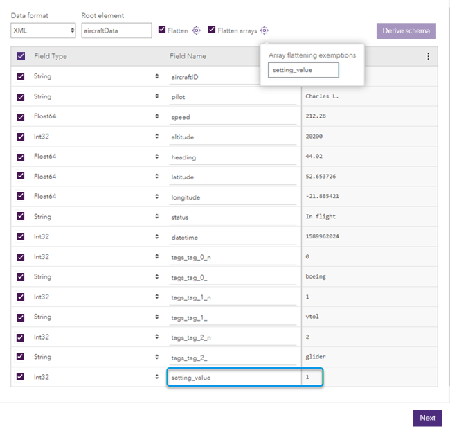

Array flattening exemptions
The Array flattening exemptions parameter allows you to specify one or more XML array names that return the last item in the array instead of divided into separate fields. Consider the following sample XML:
<flight>
  <aircraftData>
    <tags>
    </tags>
    <setting>
      <value>3</value>
      <value>2</value>
      <value>1</value>
    </setting>
  </aircraftData>
</flight>
If the Flatten arrays parameter is checked, and an Array flattening exemptions parameter value of setting_value is specified, the sample XML above is processed as illustrated in the following example. In the setting array, only the last item in the array is returned. To indicate that multiple arrays are to be exempted from flattening, use commas in the Array flattening exemptions parameter to separate values.
<flight>
  <aircraftData>
    <setting>
      <value>1</value>
    </setting>
  </aircraftData>
</flight>
The following example illustrates the schema represented in Velocity:
Resulting confirm schema page shows the setting_value field returns the last item in the array.
