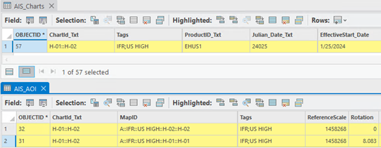

  • The following image shows an example of a populated AIS_Charts table row with its two corresponding AIS_AOI feature rows:
    AIS_Charts table row with corresponding AIS_AOI feature rows populated

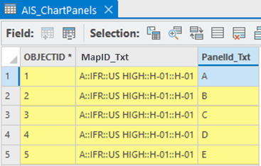

  • If you select the Has Panels option for the Summary Table preference, you must populate the AIS_ChartPanels polygon feature class with panel geometry and populate its MapID_Txt field with the value of its corresponding AIS_AOI and its PanelId_Txt field with the panel ID.
    The following image shows an example of a populated AIS_ChartPanels table's rows:
    AIS_ChartPanels table with rows populated
