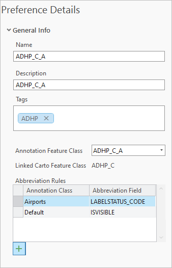

Add preferences
The Preferences tab allows you to populate a geodatabase's preferences table with preferences for the Process ATS Routes, Generate Airspace Lines, Generate Airspace Areas, Generate Aviation Chart Leads, and Report Aviation Chart Changes tools.
To add preferences, complete the following steps:
  1. In the Aviation Preferences view, choose the preference to add from the Add Preferences group on the ribbon:
    • Generate Airspace Lines—Specify how the Generate Airspace Lines tool generates airspace lines from input airspace boundary features.
    • Generate Airspace Areas—Specify how the Generate Airspace Areas tool generates airspace areas from input airspace features.
    • Generate Chart Leads—Specify how the Generate Aviation Chart Leads tool generates Chart Leads from the input map frame.
    • Report Chart Changes—Specify how the Report Aviation Chart Changes tool identifies data changes between two enterprise geodatabase versions.
    • Process ATS Routes—Specify how the Process ATS Routes tool identifies and processes route features.
    • Generate Summary Table—Specify how the Generate Summary Table Data tool gathers information from related tables and generates a single user-defined table.
    • Abbreviate Annotation—Specify how the Aviation Abbreviate conversion command in the Annotation tool applies abbreviate rules and updates the labeling of annotation features.
    A new record appears.
    Nota:
    A red box next to the new record indicates that the record is invalid and cannot be used to populate a preferences table. A record is considered invalid if the preference is a duplicate value or if the preference contains incomplete information.
  2. Click the new record.
  3. Go to the Preference Details pane and expand the General Info section.
  4. In the Name text box, type a unique name that defines the preference you are creating.
    Nota:
    You cannot have multiple preferences of the same type with the same name. For example, you can have two separate preferences called Airspace Route for the Process ATS Routes and Generate Airspace Lines tools. You cannot, however, have two preferences called Airspace Routes for the Generate Airspace Lines tool.
  5. In the Description text box, type a unique description for the preference.
  6. In the Tags text box, type descriptive tags for the preference.
  7. Continue configuring the preference you chose in the appropriate section below:
