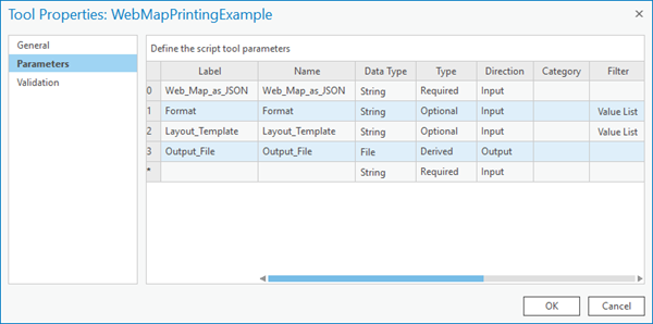

Script tool parameters
When using ConvertWebMapToArcGISProject in a web tool in ArcGIS Experience Builder, ArcGIS Maps SDK for JavaScript or ArcGIS Web AppBuilder, the parameter names of the script tool must match the Print task or Print widget parameters described in the following table:
Script tool parameter name
Data type
Type
Description
Web_Map_as_JSON
String
Required
A JavaScript Object Notation (JSON) representation of the state of the map to be exported as it appears in the web app. JSON is the format of the web map. It contains the full state of the web map (for example, layers, coordinate system, extent, scale, and so on). ArcGIS Experience Builder, ArcGIS Maps SDK for JavaScript and ArcGIS Web AppBuilder allow you to get this JSON string from the web app.
Output_File
File
Derived
The output file name. The extension of the file depends on the Format parameter.

The following screen capture shows a sample script tool's parameters:
Sample script tool parameters

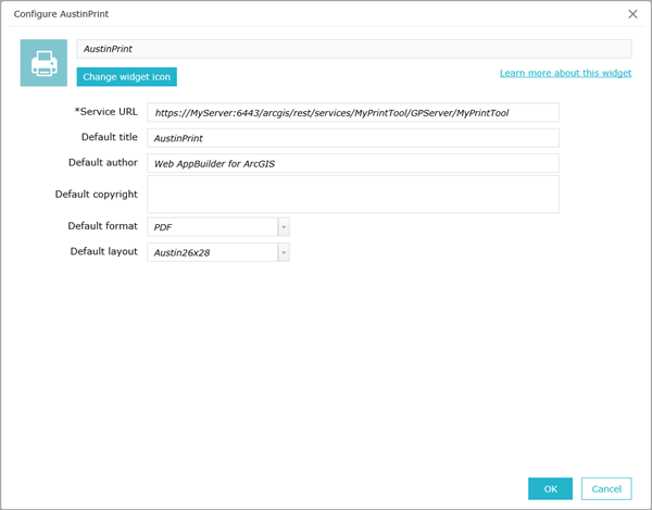

Example 2: Use a custom Python script in ArcGIS Web AppBuilder
After sharing the Python script tool as a web tool, the Print widget in ArcGIS Web AppBuilder is configured to use the REST URL of the web tool. The following screen capture shows the configuration dialog box for the Print widget:
The configuration dialog box for the Print widget
Conseil :
In the screen capture above, the values for Default format and Default layout are automatically populated from the Format and Layout_Template parameters from the web tool.
