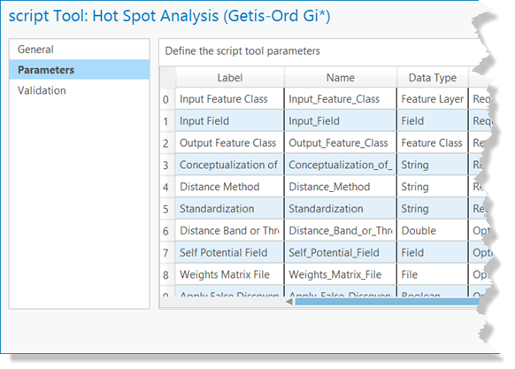

Parameter order
A tool's parameters and their order are defined on the Parameters tab of the tool's properties, as illustrated in the image below.
Parameters and their order
注意:
The list of parameters is zero based, so the first parameter is at position zero in the list. To access the third parameter, you would enter p3 = self.params[2].
