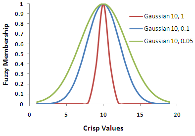

The FuzzyGaussian function is similar to the FuzzyNear function but has a more narrow spread.
Fuzzy Gaussian graph
Variations of the Fuzzy Gaussian membership function.
