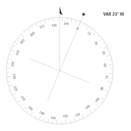

The compass rose north arrow element is a topographic north arrow with a 360-degree dial oriented toward magnetic north. This element is primarily displayed on the Evasion Chart (EVC) map product. The magnetic variation (VAR) value is calculated from the center of the compass rose and rounded to the nearest whole degree.
Compass rose north arrow
Topographic north arrow elements consists of declination diagrams that represents three ways of defining north:
  • Grid north (GN)—The north established using the vertical grid lines on the map. Grid north is automatically calculated based on the center point of the chosen map frame.
    注意:
    This north is not included on the EVC compass rose element.
  • Magnetic north (MN)—The direction to the north magnetic pole, as indicated by the north-seeking needle of a magnetic instrument. It is symbolized by a line ending with half an arrowhead. Magnetic north is automatically calculated based on the center point of the chosen map frame and the selected date.
  • True north—A line from any point on the earth's surface to the north pole. All lines of longitude are true north lines. It is represented by a star at the end of a line.
