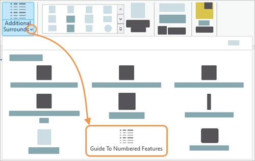

  2. Click the Insert tab.
  3. Click the Additional Surrounds drop-down arrow and click Guide To Numbered Features in the Topographic group.
    The Guide To Numbered Features surround element in the Additional Surrounds gallery
  4. Click where you want to insert the element on the layout.
The element is added to the layout.

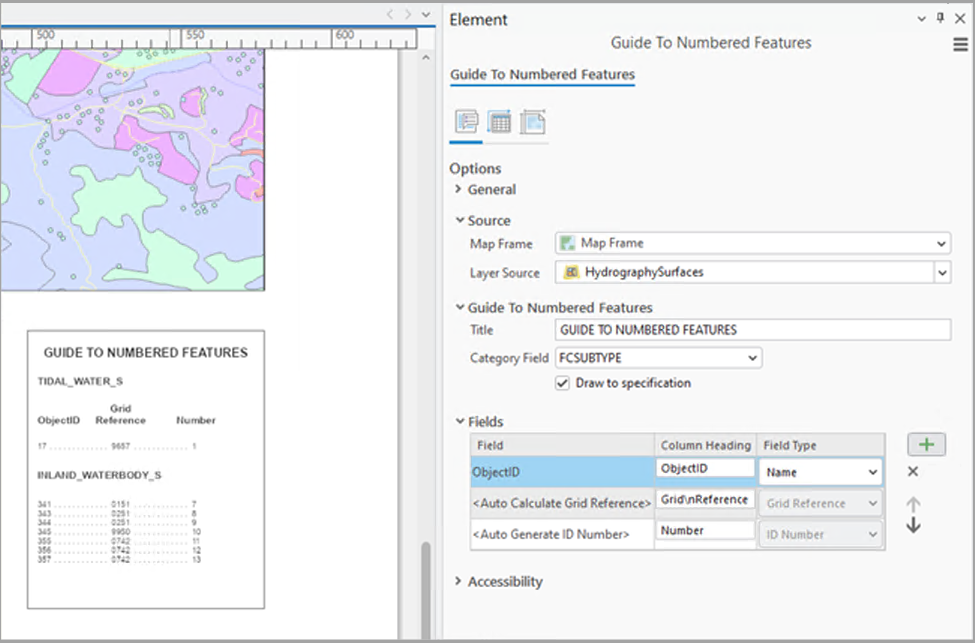

  8. Expand Guide To Numbered Features and configure the element's title and grouping options.
    1. Provide a title for the element in the Title text box.
    2. Click the Category Field drop-down arrow and specify the field that sets which features will be grouped together on the element.
      The field you specify contains the values used for category headers on the element.
    3. Specify whether the element appears at a fixed height and width according to the specifications of the map product by checking or unchecking the Draw To Specification check box.
      If the Draw To Specification check box is checked, the element cannot be resized.
  9. Expand Fields to configure the element's fields.
    The Fields table on the Guide To Numbered Features element
    ヒント:
    If you're using Tab to move through the table, the selected row remains selected when you move focus to the options that add, remove, or reorder a row.
    Item
    Details
    Add a row after the selected row to the Fields table. This creates a column in the element.
    The field from which values are derived for the element.
    Provide a name for the column header that appears on the element.
    Specify the field type. The options are as follows:
    • Grid Reference
    • ID Number
    • Name
    5
    Change the order of the element's columns by moving the selected row up or down.
    6
    Remove the selected row from the table. This deletes a column in the element.
    ヒント:
    If the Field Type value is set to ID Number, the associated Field value becomes <Auto Generate ID Number> and ID numbers are automatically generated in the element. To source Field values from the feature class attribute table, leave the Field Type value empty.

The layout contains a Guide To Numbered Features element to help find a feature on the map.
ArcGIS Pro Element pane for a Guide To Numbered Features element with the element in view on a layout
