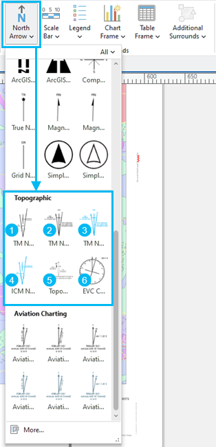

The ArcGIS Topographic Mapping extension includes several topographic north arrow options in ArcGIS Pro that meet industry map product specifications.
Topographic north arrow gallery in ArcGIS Pro
Item
Name
Details
TM North Arrow
Used with the following map products:
  • Multinational Geospatial Co-production Program (MGCP) Topographic Map (MTM)—Derived from MGCP data using the Technical Reference Documentation (TRD) data schema.
  • Topographic Map (TM)—Derived from Topographic Data Store (TDS) data using Data Product Specification (DPS) schema.
TM North Arrow - Small
TM North Arrow - Small Cyan
ICM North Arrow
Used with the Image City Map (ICM) map product.
5
Topo North Arrow
General topographic north arrow.
6
EVC Compass Rose
Used with the Evasion Chart (EVC) map product.

  2. Click the Insert tab.
  3. Click the North Arrow drop-down arrow and choose a north arrow from the Topographic group.
  4. Click the layout where you want to insert the topographic north arrow.
    The topographic north arrow is added to the layout and remains active.

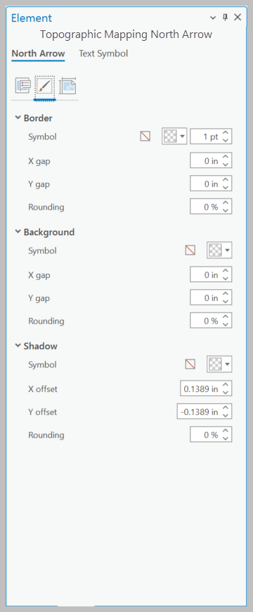

  4. In the Element pane, click the Display tab to configure the element's display settings.
    1. Configure the element's border in the Border section.
    2. Configure the element's background in the Background section.
    3. Configure the element's shadow in the Shadow section.
      Element pane with Display tab active and Border, Background, and Shadow sections expanded

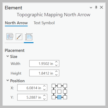

  5. In the Element pane, click the Placement tab to configure the element's placement options.
    1. Specify the element's size.
      Resizing is unavailable if the Draw To Specification check box on the Options tab is checked.
    2. Specify the element's position.
      Element pane with Placement tab active and Size and Position sections expanded
    These settings can also be set from the element's contextual tab in the Size & Position group.
