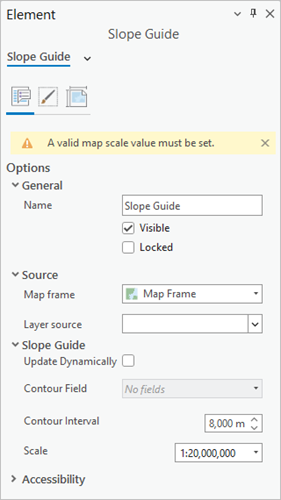

A warning message will appear in the Element pane and the Slope Guide element will not be drawn on the layout if invalid element properties are present, such as a map scale that exceeds 1:250,000. Warnings appear one at a time. If there is more than one invalid element, each warning is shown in turn until resolved.
Element pane showing Slope Guide element properties with a warning message.

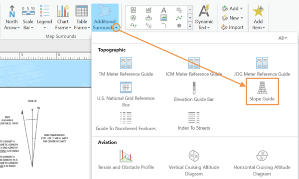

  2. Click the Insert tab.
  3. In the Map Surrounds group, click the Additional Surrounds drop-down arrow and choose Slope Guide under Topographic.
    Slope Guide element in the Additional Surrounds drop-down options
  4. Click an insertion point in the active layout to place the new Slope Guide element.
    The Slope Guide element is added to the layout at the insertion point and remains selected.
  5. Optionally, place the pointer over the selected Slope Guide element until the move pointer appears and drag it to a new location.

To modify more Slope Guide element properties in the Element pane, complete the following steps:
  1. Double-click the Slope Guide element in the Contents pane to open the Element pane.
    The Element pane appears with the Slope Guide properties visible.
  2. Specify the following details in the General section:
    注意:
    The size commands aren't available for this element because its size is fixed to meet map product specifications.
    • Name—The name of the element as it appears in the Contents pane. The name must be unique.
    • Visible—Check or uncheck this check box to display or hide the element.
    • Locked—Check this check box to prevent changes to the element in the layout.
  3. Click the Map frame drop-down arrow to specify a map frame for the Slope Guide element to reference.
  4. Click the Layer source drop-down arrow to specify the index feature class layer in the active map for the Slope Guide element to reference.
  5. In the Slope Guide section, uncheck the Update Dynamically check box to specify the scale and contour interval manually.
