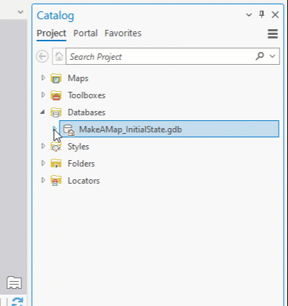

  1. In the Catalog pane, right-click the geodatabase, and click New > Table.
    Adding a table to a geodatabase in the Catalog pane
    The Create Table pane appears.
