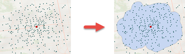

Иллюстрация
Generate Customer Derived Trade Areas tool illustration
