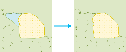

Eliminates a polygon by merging it with the polygon from the surrounding features that it shares the longest boundary with.
Иллюстрация
Eliminate Polygon functionality

  • This tool is used in situations where topology exists between feature classes. An example is when you have a topology rule that lakes and vegetation should not overlap and a lake feature needs to be removed to accommodate the rule.
  • Features to be eliminated are determined by the selection applied to the Input Features. If no features are selected, all features in the Input Features feature class will be considered for elimination. When a minimum area is specified, only those features, or selected features, that are smaller than the Minimum Area will be considered for elimination.
  • The geometry of each input feature considered for elimination is added to an individual feature from any of the surrounding feature layers that it shares the longest boundary with. For instance, if a feature shares a longer boundary with a feature from layer A and a shorter boundary with a feature from layer B, the feature will be merged with the feature from layer A.
