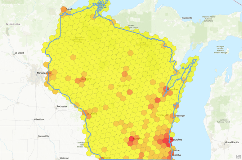

A commercial health organization in Wisconsin is analyzing state-wide trends in health-care preferences. The organization uses hexagons in a color-coded layer with two different resolutions to analyze areas of highest preference for urgent care facilities over doctor's offices.
They select a variable from the Market Potential data, Prefer Urgent vs Docs Office: Agree Completely, and set the area of interest to Wisconsin. The variable is mapped using resolution 5 hexagons.
Hexagons mapped in Wisconsin
Hexagons vary in size (or resolution) from 0 (largest) to 15 (smallest). For a state-wide analysis, resolution 5 hexagons cover a large area, aiding the organization's analysis by providing a broad visualization of data. For more information on hexagon resolutions, see Hexagon resolutions.

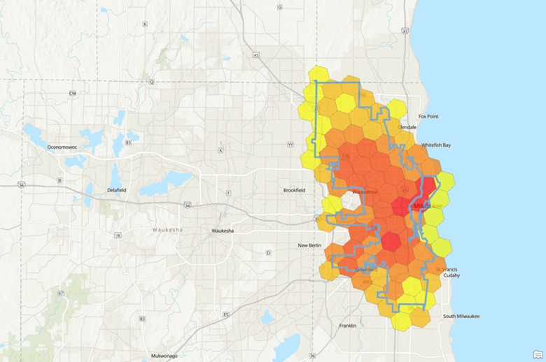

There are a large number of people who prefer urgent care facilities concentrated around Milwaukee, which the organization wants to further evaluate. They change the area of interest to the city of Milwaukee and change the hexagons to resolution 7. This larger resolution hexagon covers a smaller area per hexagon and is applicable to local analysis since it provides a more specific visualization of data.
Hexagons mapped in Milwaukee

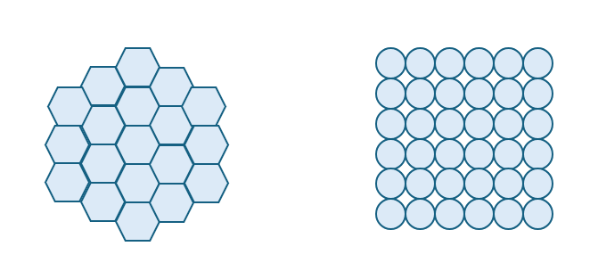

Hexagons are six-sided polygons that tessellate. Tessellation is when polygons repeat in a pattern in which each unit fits with its neighbor without gaps or overlapping. This continuous pattern allows the curvature of data to be uninterrupted, unlike using squares in a grid on a map.
Hexagon tessellation and square grid
The shape of the hexagon provides a unique advantage in data analysis and visualization. For instance, a circle can be inscribed within a hexagon. A circle has the lowest perimeter-to-area ratio, which reduces sampling bias, but it cannot tesselate continuously. (A repeating pattern of circles has gaps or overlaps, which is not effective for analysis.) However, a hexagon can tesselate while having a low perimeter-to-area ratio.
Hexagon tessellation and circle grid

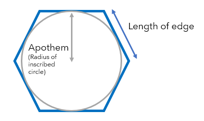

The radius of the circle inscribed within the hexagon is called the apothem. The length of the edge of the hexagon is equal on all sides. The apothem and side length of a hexagon are not always equal.
Diagram of hexagon
