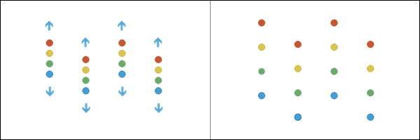

The first method for accounting for vertical and horizontal difference is the elevation inflation factor. It is a positive number that is multiplied to the Elevation field value prior to subsetting and model estimation. By multiplying the elevation values by this value, you stretch the elevations of the points vertically while keeping the horizontal coordinates the same. After making predictions in the stretched coordinates, the results are stretched back to the original coordinates before displaying the results in the map.
Points stretched in 3D
The goal is to choose an inflation factor where the measured values of the stretched points change at the same rate vertically as horizontally. For example, if the values of some points change on average five times faster vertically than they do horizontally, multiplying the elevation values by five will result in new coordinates where the values of the points change at the same rate horizontally as vertically. Stretching the elevation values in this way allows accurate estimation of the semivariogram, and it allows the search neighborhood to find appropriate neighbors and assign correct weights.

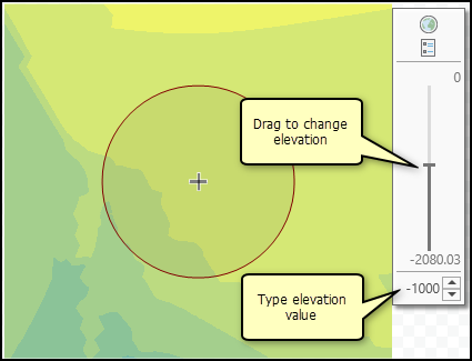

You can change the elevation of the preview surface by either dragging the elevation slider on the right of the preview surface or typing a value beneath the slider. This allows you to interactively view horizontal transects at different elevations. This experience is analogous to using the range slider to change the elevation of the geostatistical layer in a map outside of the wizard. You can also change the elevation by typing a value into the Z coordinate on bottom-right section of the preview page.
Elevation slider in Geostatistical Wizard
The Elevation inflation factor will optimize itself by default. If you change any other parameters, such as the semivariogram model or the subset size, you can calculate a new optimal elevation inflation factor using the Optimize button .
